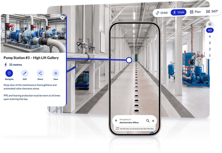

Manufacturing and industrial facilities
The navigation problem: Manufacturing sites and industrial facilities contain thousands of individually catalogued assets, valves, pumps, electrical panels, safety equipment, machinery, spread across large, physically complex environments. Technicians and contractors need to find specific assets quickly and accurately.
Why traditional approaches struggle: Asset location relies on local knowledge. New technicians and contractors can't find assets without being escorted. Asset management systems contain location data, but navigating to that location indoors isn't supported.
What effective industrial navigation looks like: A maintenance technician searches for valve HV-234 or fire extinguisher zone B7 and follows turn-by-turn directions from their current location. Contractors navigate independently on their first visit without needing an escort. Safety-critical assets, eyewash stations, first aid kits, emergency shutoffs, are findable by anyone in seconds, not just experienced staff.
Key outcomes:
  • New contractors navigate independently from day one. Experienced staff stop losing time to escort duties.
  • Maintenance response time to specific assets drops. Engineers arrive at the right location on the first attempt.
  • Safety asset location time decreases significantly. In an emergency, this matters.
  • Health and safety compliance becomes demonstrable. You can show that any person on site can find a fire extinguisher or first aid point within seconds, not minutes.
  • When plant layouts change, the navigation system updates to reflect the new configuration rather than pointing people to where things used to be.
Example destinations: Plant rooms, electrical panels, valves, pumps, fire extinguishers, eyewash stations, first aid points, emergency exits, loading bays, offices, welfare facilities, control rooms, specific machinery.
Pilot starting point:
  1. 1. Map safety-critical assets first. Fire extinguishers, eyewash stations, first aid kits, emergency shutoffs, AEDs. This is your strongest pilot scope: it's immediately justifiable, it has a clear compliance angle, and it affects everyone on site.
  2. 2. Work from your asset management system. If you have a CAFM or EAM system with location data, your navigation vendor should be able to ingest that data and place POIs on the floor plan. This is faster than manually cataloguing every asset.
  3. 3. Test with a new contractor before going wider. Give a contractor who has never visited the site a task: find asset X. Time it. Ask them where they got confused. This surfaces navigation gaps faster than any internal test.
  4. 4. Plan for dynamic areas separately. Areas where equipment moves frequently (production lines, staging areas) may need QR anchor points rather than VPS, since the spatial scan can become outdated. Identify these zones before the pilot.
Discover how you can deploy Zapworks Spaces at your factory or industrial facility.

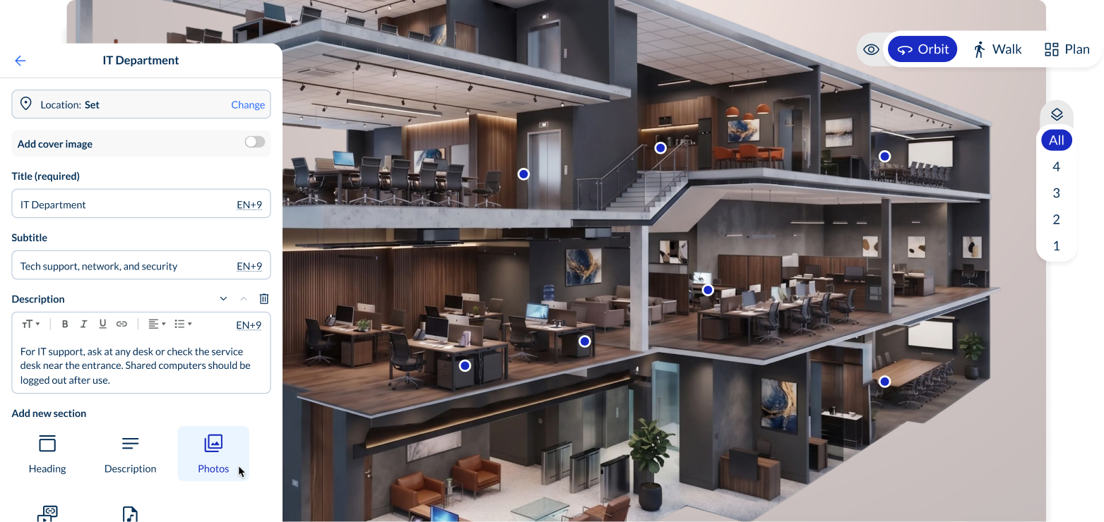

Corporate offices and workplace campuses
Who this is for: Workplace experience managers, facilities management, IT services, reception and visitor management teams, HR and onboarding leads.
The navigation problem: Large corporate campuses, particularly multi-building headquarters, financial district towers, or sprawling tech campuses, present significant navigation challenges for visitors, contractors, new starters, and staff who rarely visit other buildings in the estate.
Why traditional approaches struggle: Room booking systems change which floor a team is on. Hot-desking policies mean there's no fixed desk to navigate to. Visitor management is complex when visitors need to find the right meeting room in a building they've never been to.
What effective workplace navigation looks like: Visitors receive a calendar invite with a link that opens navigation directly to their meeting room. Contractors find the server room, comms riser, or plant room without calling facilities. New starters explore the building before their first day. Hot-desking environments become navigable because the system reflects current team locations, not last year's seating plan.
Key outcomes:
  • Visitors arrive at meeting rooms without calling reception or getting a staff escort.
  • Contractors operate independently from their first visit. Facilities teams stop spending time on escort duties.
  • New starter onboarding time shortens. People feel confident in the building within days rather than weeks.
  • Facilities support tickets related to "where is X?" drop measurably.
  • Workplace experience scores improve. The building feels well-run rather than confusing.
Example destinations: Meeting rooms, hot desks, team areas, café, gym, roof terrace, bike store, shower rooms, IT support, first aid, fire exits, accessible routes, post room.
  1. 1. Start with the visitor journey. Reception to the most common meeting rooms is the highest-friction path and the most visible quick win. Map it, test it, and get it right before expanding.
  2. 2. Connect it to your calendar system. A meeting invite that includes a navigation link is a significant improvement for visitor experience. Most indoor navigation platforms support this integration; treat it as a day-one requirement, not a nice-to-have.
  3. 3. Identify the 20 destinations contractors most commonly need. Server rooms, plant rooms, comms risers, roof access, loading bays. These are often not on standard visitor floor plans. Get them mapped.
  4. 4. Measure baseline first. Count how many times reception or facilities fields a "where is X?" call in a typical week before launch. That number becomes your before/after metric.

Step 4: Add destinations, POIs, and accessibility annotations
This is where the navigation becomes useful. In Zapworks Spaces we make this incredibly easy through a simple, drag-and-drop interface that anyone on your team can use.
Add:
  • Searchable destinations (rooms, departments, assets, services)
  • Points of interest (café, toilets, lifts, emergency equipment)
  • Categories (so users can browse by type rather than searching by name)
  • Named landmarks (to anchor audio instructions)
  • Guided routes (pre-defined tours or operational routes)
  • Rich content attached to destinations (photos, descriptions, contact information)
Don't leave accessibility for a final phase, annotate it alongside everything else:
  • Step-free routes
  • Lift locations (and accessible entry points to lifts)
  • Ramp locations
  • Wide-aisle corridors and accessible toilets
  • Any other accessibility-relevant features
