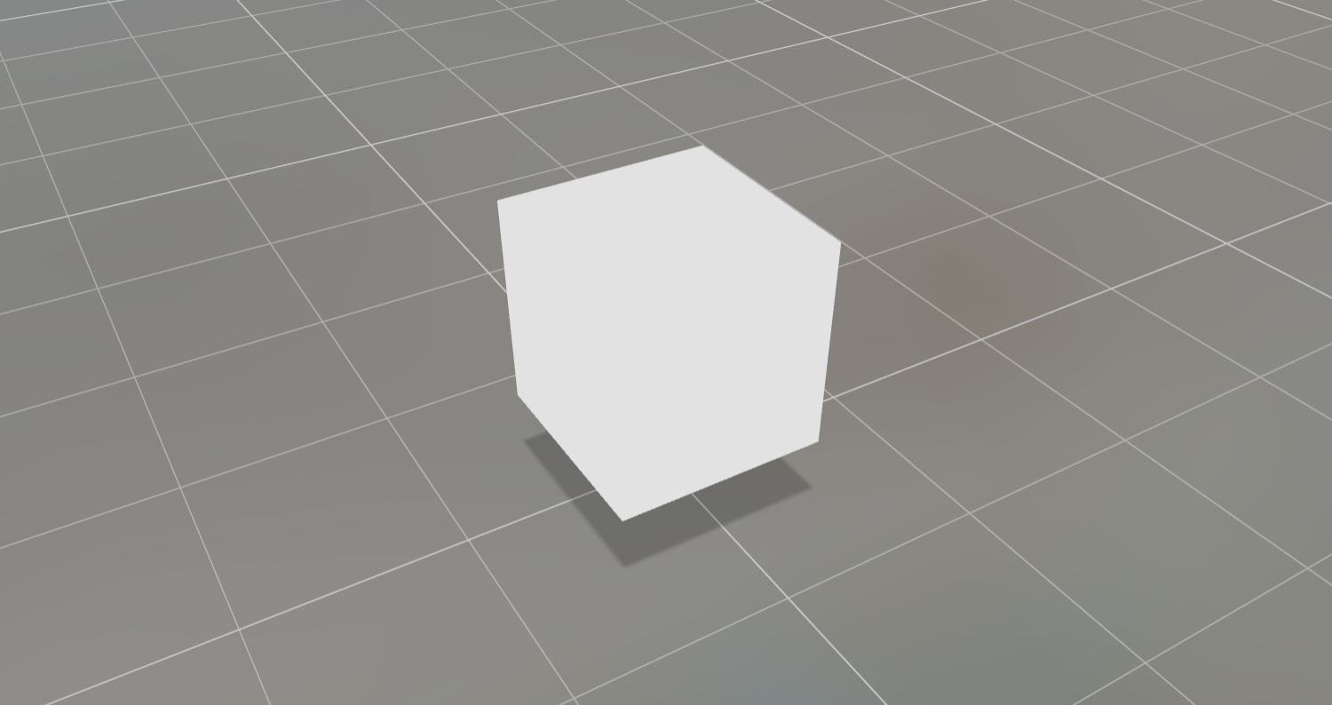

A blank 3D project with support for Immersal's VPS for real-work positioning of AR content.
Once the project is created, check out the ImmersalAnchorGroup in the Hierarchy of Scene.zcomp. The following steps should get you up and running in no time.
1. Visit https://developers.immersal.com/ and set up an account.
2. Create a map of the space you'd like to build content for with Immersal's mapping app.
3. Add your developer token and map ID to the ImmersalAnchorGroup's properties. Feel free to explore the other options.
4. Build your content inside the ImmersalAnchorGroup.
